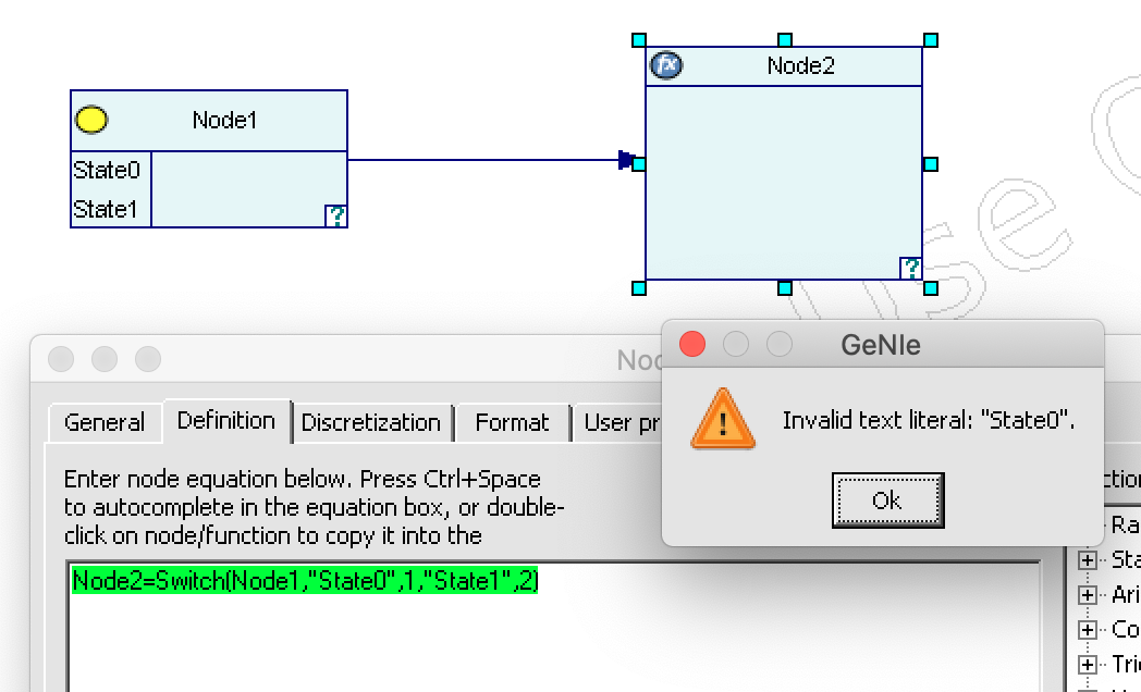

1) version with text, and error report:
Schermata 2022-08-04 alle 18.10.10.png (140.04 KiB) Viewed 45248 times

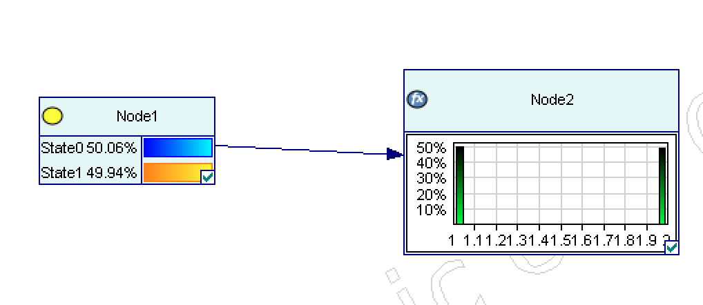

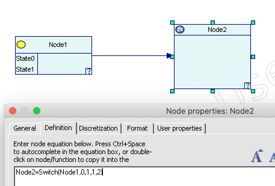

2) version with number values:
Schermata 2022-08-04 alle 18.10.36.png (71.6 KiB) Viewed 45248 times
3) the version with number values works:
Schermata 2022-08-04 alle 18.10.53.png (30.14 KiB) Viewed 45248 times

Re: Bug in the Switch function of GeNIe4.0
Thanks for spotting the bug. We'll fix it in the next service release.
As a temporary workaround, please consider using the If() function, which supports state literals in GeNIe 4.0. For example:
Node2=If(Node1="State0", value_for_state0, value_for_other_states)
