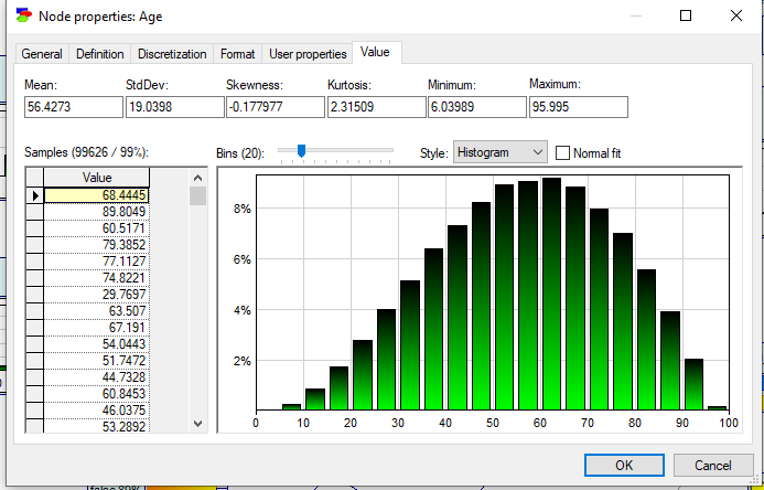

here is the same bayesian network except that in this one I customized the definitions of the nodes and the "x" of the histogram are the same as in the dataset and are more logical for example the age the x are: 10,20,30,40,50,60... etc as my data and as shown in the picture in the tab "node property -> value" the max and min are in the proposed range [6,96] but I still have this error "Discretization problem in node Age: Underflow samples: 91, min=1. 50963 loBound=6 Overflow samples: 322, max=99.5983 hiBound=96 Total valid samples: 99587 of 100000" after doing "rediscretize" and I still don't understand and is it going to influence the inference result?
another problem: I have arcs that are always in gray such as the arc between morbid_obesity and diabetes, is that going to be a problem for me later?

Re: ERROR
I’m on the road, so I will be very brief. A small percentage of invalid samples is generally not a problem. Gray arcs tell you that there is something wrong with the definition of the child. They mean, essentially, that they are not necessary (the child is independent of the parent), which means that you probably need to revisit the definition.
