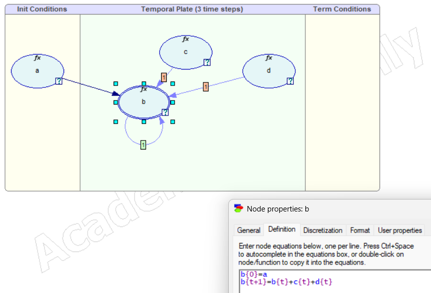

I would like to confirm whether temporal nodes can be defined using equations in PySmile. For illustration:
b{0} = a
b{t+1} = b{t} + c{t} + d{t}, where a, c, and d follow Uniform distributions.
While developing a model, I noted the function:
set_node_temporal_equations(node: int | str, equations: List[str])
During execution, an error occurred. Could you clarify the format in which these temporal equations should be provided? In Genie, a new line is added for each temporal equation
Is there an example available for reference?
b{0} = a
Thank you very much.

Re: Equation Model
Support for continuous/hybrid dynamic Bayesian networks was added to PySMILE. It will be released as part of the next SMILE update. Private build is available for those users who need to work with equation nodes in DBNs.
