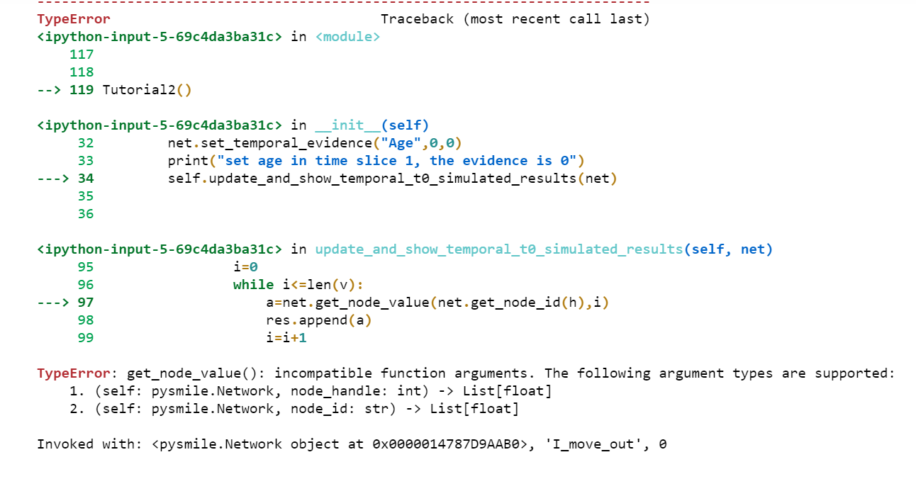

to make the simulation procedure, i set evidence for one situation by "net.set_temporal_evidence("Age",0,0)", then it works. when i add the simulation procedure in my code, i got the TypeError in the picture.i upload my code and error in the attachment. could you please tell me how to modify my code? Thank you very much!

a=net.get_node_value(net.get_node_id(h),i)
get_node_value method call is invalid - it takes only one argument (node ID or handle). I am not sure if this loop is necessary
while i<=len(v):
	res.append(a)
	i=i+1
Because you already have node value in v variable (line 93)
