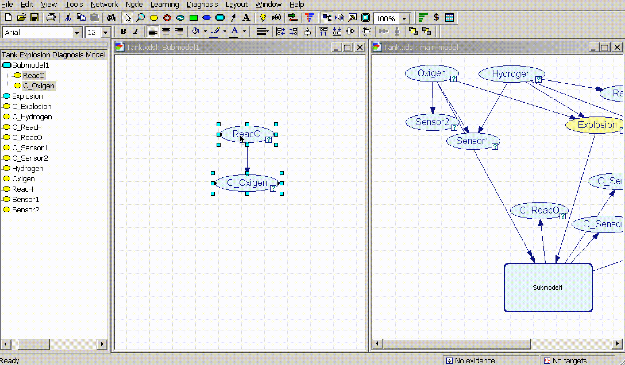

- Posts: 1496
Re: Submodel - a question + a suggestion
Dragging nodes between submodels works for me. See the attached animated gif; are you referring to some other drag'n'drop action?The result: those relocated nodes just stay there in coexistence with the submodel node that previously represents them.
- drag-between-submodels.gif (963.72 KiB) Viewed 21940 times
Thanks. It's my ignorance. I thought once the nodes in the submodel window were dropped back to the main window the submodel node in the main window will automatically disappear. It's OK.
