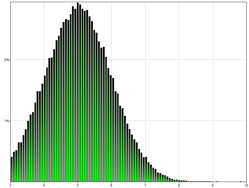

Try using TruncNormal(5,1,3) distribution - see the attached image for sampling results (the cutoff to the left of 3.0 is real, it's not just a histogram displaying a subset of samples). Any of the three fixed parameters in this example can be replaced by an expression, so you're not limited to fixed threshold of 3.I want to create a truncated distribution - e.g. a normal distribution N(5,1) be truncated at a threshold, say 3, so that there is no frequency of occurrence before the threshold (3). Making it bit more complex is that the threshold itself is stochastic subjected to a distribution (rather than a fixed number e.g. 3
