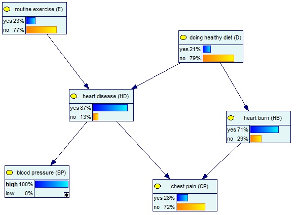

I build a simple model about heart disease (please find the model in attachment). I define also all CPTs. I am trying to compare the Genie's result with manual bayes calculation (in order to improve my knowledge in bayesian concept). But I found the result different.
I want to know the probability of someone getting heard disease if he has high blood pressure.
According to bayes rule:
P(HD=yes | BP=high ) = P( BP = high | HD=yes) x P (HD=yes) / P(BP=high)
According to the CPT value in the model:
P( BP = high | HD=yes) = 0.85
P (HD=yes) = 0.39 -> I got also this number when calculate manually
And P(BP=high) can be elaborated into:
P(BP=high) = P( BP = high | HD=yes) x P (HD=yes) + P( BP = high | HD=no) x P (HD=no)
P(BP=high) = 0.85 x 0.39 + 0.2 x 61
P(BP=high) = 0.45
So,
P(HD=yes | BP=high ) = 0.85 x 0.39 / 0.45
= 0.73
But why Genie give probability of heart disease “yes” is 0.87 and not 0.73? (please see attached picture). Can you explain to me? Am I doing it wrong or what?
Thanks again for your respond!

One error that I see in your calculation is that you assumed/calculated P(HD=yes)=0.39. Actually, P(HD=yes)=0.61 and P(HD=no)=0.39, so you may have made an error here. Does this solve your problem?
I love to hear that you are going to use GeNIe in your research. GeNIe is incredibly popular in the academia. Price is one factor but I believe it is the quality of the software that makes all the difference. Please remember about acknowledging GeNIe in your publications! Please do not hesitate to contact us in case of any problems.

Thanks for your answer. Yes, that's my mistake.
