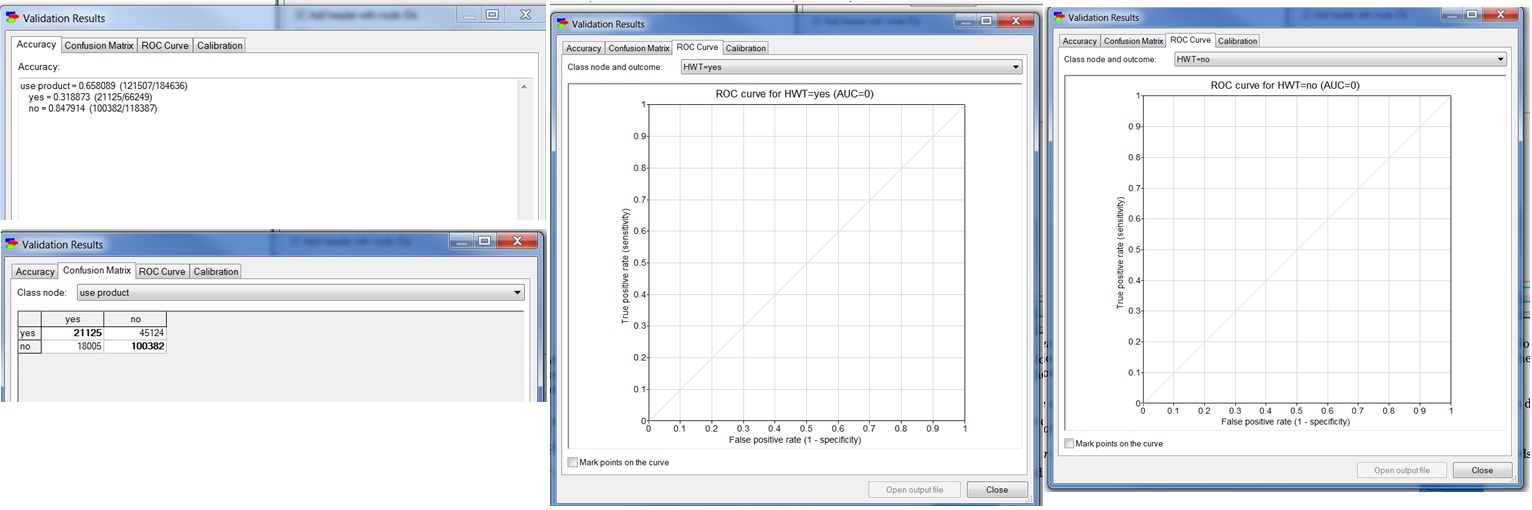

2. When I validate my model (using test only), the accuracy is 65%. the model can predict the outcome node: "no" (84% correct prediction) better than "yes" (only 31% correct prediction). But Why do I not get any picture in my ROC curve? it's totally empty. Please see the picture in the attachment.
Thanks for your help!
If you don't mind, I have more questions :)
1.
Sorry, I did not get this. What do you mean by looking at the output file?Have you tried looking at the output file? You can see the posterior probability distributions over the class variable for each of your data records
- no result on ROC curve
- empty ROC curve.jpg (151.32 KiB) Viewed 24678 times

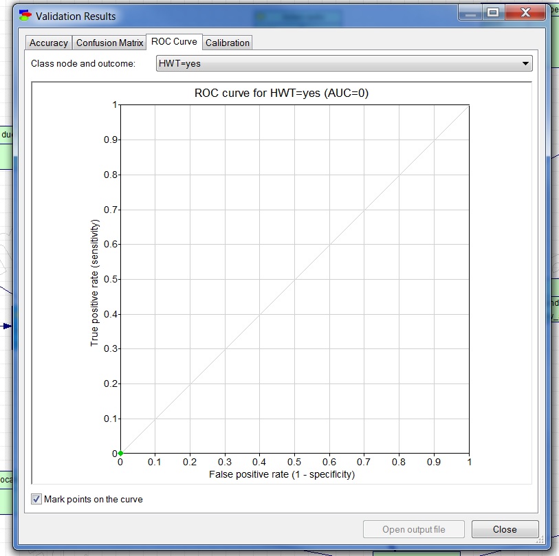

Can you click on the 'Mark points on the curve' checkbox and repost the images?But Why do I not get any picture in my ROC curve? it's totally empty. Please see the picture in the attachment.

When I click the checkbox, green point appear in the left bottom corner (0,0).
- Untitled12.jpg (122.84 KiB) Viewed 24674 times
Re: Ask learning process, fixed nodes, and validation process
When you run validation, you can create an output file. It will replicate each of the records and show you the probabilities assigned to each of the classes (please look at the Validation dialog). This should be insightful for you.danielhombing wrote: 1.Sorry, I did not get this. What do you mean by looking at the output file?Have you tried looking at the output file? You can see the posterior probability distributions over the class variable for each of your data records
From the picture that you placed in reply to Tomek, it looks like your classifier produces zero probability for every instance of HWT=Yes. There is clearly a problem with your model. If you post your model, I will be glad to have a look at it.danielhombing wrote: 2. When I validate my model (using test only), the accuracy is 65%. the model can predict the outcome node: "no" (84% correct prediction) better than "yes" (only 31% correct prediction). But Why do I not get any picture in my ROC curve? it's totally empty. Please see the picture in the attachment.
