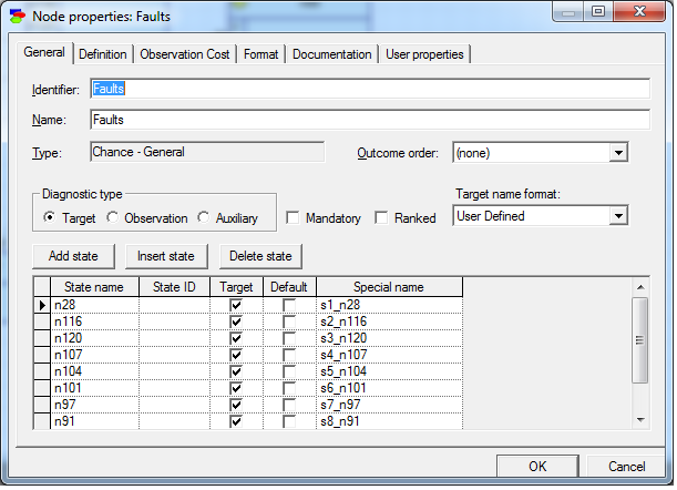

Is it possible to set the target names for the set of states associated with a node of Diagnostic type: Target ?
In the Genie UI, this can be done in the General tab of the Node properties dialog. Specifically, I would like to do the equivalent of setting the Target name format dropdown menu to User Defined, and then changing the name for each state as shown in the Special name column. I would like to perform this sequence of operations in Java using the jsmile library.
See the attached screen-shot of the dialog.

- The Node properties dialog
- NodeProperties.png (39.49 KiB) Viewed 18501 times

You can use one of the Network.setOutcomeLabel and Network.getOutcomeLabel overloads. These methods operate on the attribute called "Special Name" in GeNIe (when "Target name format" is set to "User Defined").
There's no jSMILE API for controlling the "Target name format" value displayed in GeNIe.

I tried Network.setOutcomeLabel and it doesn't set the string in the "Special Name" column - it instead sets the string shown in the "State ID" column. I also tried Network.setOutcomeDescription (also unsuccessful).You can use one of the Network.setOutcomeLabel and Network.getOutcomeLabel overloads. These methods operate on the attribute called "Special Name" in GeNIe (when "Target name format" is set to "User Defined").
Any other ideas?

You're right, the get/setOutcomeLabel methods do not work with the "Special name". Generally, the per-outcome attributes are a mess due to backward compatibility.raywonqa wrote:I tried Network.setOutcomeLabel and it doesn't set the string in the "Special Name" column - it instead sets the string shown in the "State ID" column.
At this point access to "special name" from jSMILE would require adding new native methods to the library, unless you can modify the .xdsl with XML processing tools externally.Any other ideas?
What platform are you using?

Using Java 1.6 64-bit and Windows 7 64-bit. Is that what you mean by platform?What platform are you using?

Yes, that's the info. I think we could consider adding the required functionality and creating an early private jSMILE build.Using Java 1.6 64-bit and Windows 7 64-bit. Is that what you mean by platform?
