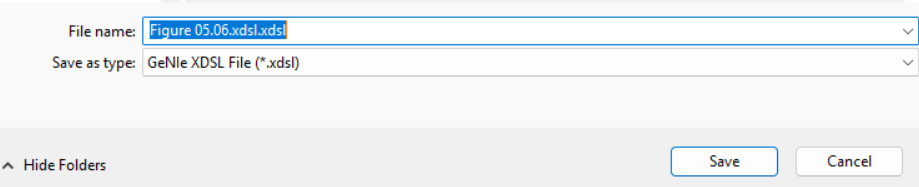

When saving an existing file under a new name using the "Save As" command, the file save dialog appends the ".xdsl" suffix to the existing file name that already has a suffix, creating a file name with duplicate suffixes. See the attachment.
This is just a minor nuisance.

- file_saveas.png (20.43 KiB) Viewed 3674 times

We can't reproduce this issue. We were trying on Windows 10 and Windows 11, using the 'Figure 05.06.xdsl' example from files copied by GeNIe installer onto the local disk, and also using the 'Open from BayesBox' command (our repository at https://repo.bayesfusion.com contains this network).
On your machine, can you check what happens when you select other file types from the 'Save as type' dropdown list?

Re: duplicate xdsl file name suffix on save as
The problem occurs by
1) Open a xdsl file using the "Open Examples..." file option
2) Choosing 'save as..."
The file name appears with the suffix .xdsl.xdsl
The problem does not appear if files are opened from other commands, such as fron the file system directly, or from BayeBox
Reproduced & fixed. We will be releasing GeNIe tomorrow (Friday, May 8th).
