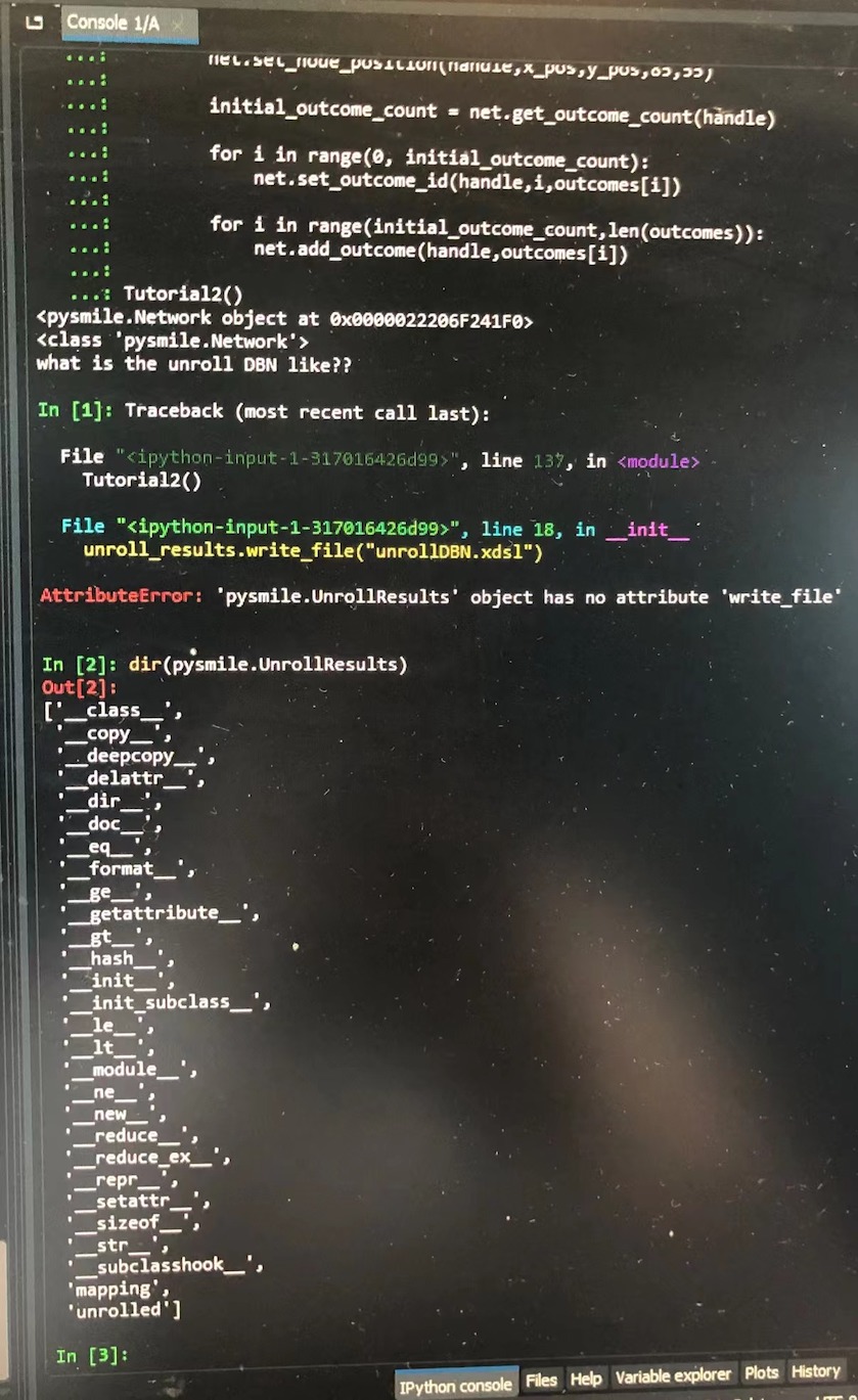

thank you very much! But when I use these two rows to save the unrolled network, it tells me " AttributeError": 'pysmile.UnrollResults' object has no attribute ' write_file'.
I use dir(pysmile.UnrollResults),write_file is not the attribute of pysmile.UnrollResults, as shown in attached picture.
could you please tell me how to store it then? thank you very much!

This is my mistake in the previous post - use write_file method on unrolled property.
unroll_results.unrolled.write_file("filename.xdsl")
