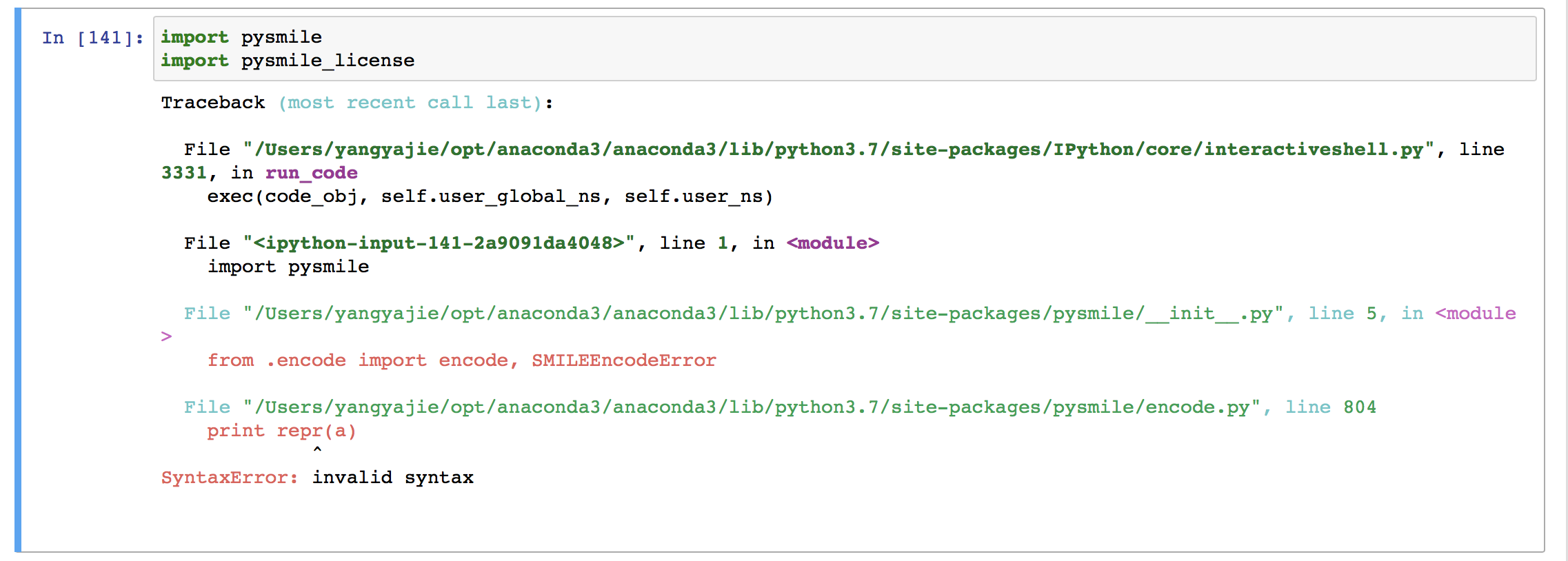

I can not import pysmile in my mac.
- Posts: 34
- Joined: Thu Mar 19, 2020 11:49 am
Dear sir or madam,
I can download "GeNIe" and pip install the "pysmile" package, and I have put the license of pysmile in the file I use it to code in python. but it shows SMILEEncodeError and print repr(a) has invalid syntax error. could you please help me solve this problem? I put the "error" in the attachments.
(I can import pymsile well when I use my previous pc which uses windows system, but my pc has some problems now, so I use my MAC pc to continue my study, but I can import pysmile well)
kind regards!
Yajie
kind regards!
Yajie
- Screen Shot 2020-07-02 at 11.28.48.png (195.05 KiB) Viewed 27910 times
- Posts: 71
- Joined: Mon Nov 06, 2017 6:41 pm
Re: I can not import pysmile in my mac.
Package installed by pip is not BayesFusion's PySMILE. To use PySMILE, you need to uninstall pysmile installed by pip.
Download PySMILE from our website - https://download.bayesfusion.com/ and uncompress archive in your project directory.
Note that PySMILE works with official Python binaries (https://www.python.org/downloads/). Python binaries installed by Homebrew (macOS) are not supported yet.
pip uninstall pysmileDownload PySMILE from our website - https://download.bayesfusion.com/ and uncompress archive in your project directory.
