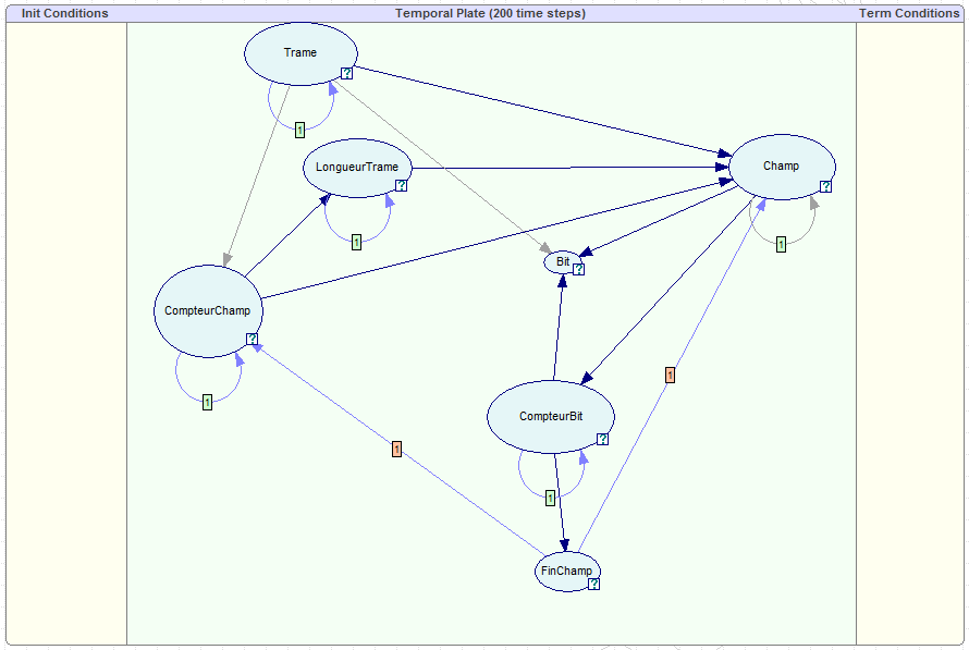

I have now more or less converged on a definitive version of my network, but when I try to launch an inference on 200 slices with observations of one node (Bit) on each slice via java code, it crashes after a few minutes with the exception "bad allocation".
I use Likelihood Sampling to do the inference. Everything works fine for 40 slices, however. My network has one huge node with around 7 million paramameters (Champ). My computer has only around 7Go of RAM, so I would like to know how I could achieve this inference without crashing. I can't join my network, as it is too big, but I join a screenshot of it :
Thank you in advance.
Re: Crash/error upon inference in a dynamic Bayesian network
Can you upload your network to Google Drive, Dropbox or similar service and send the link?
